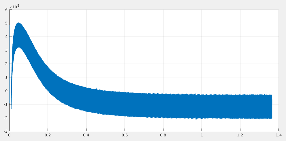

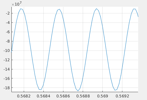

Screenshot of the microphone-data with a 2.6kHz sinus-signal:
2018-09-06 8:26 AM
> Only the solution is a bit improvised.
I understand your sentiment, but in many if not most audio applications the data need to be manipulated somehow anyway.
> Is it possible to configure the DMA so that the 32Bit value is directly correct?
No, i.e. 32-bit I2S in the SPI/I2S module with its 16-bit data register inevitably results in the data swap (and the more usual 24-bit I2S feels maybe even more weird in this regard). There's no way to "reverse" the DMA's address register increment direction, and the DMA does not support reordering even in the FIFO mode. If this is a priority for you, use the SAI module instead of SPI/I2S.
