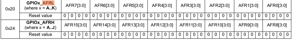

> Do I have to write a five somewhere? In the AFR5-Section?
Yes; but in Cube the "magic" in the init function as mentioned above does that. I do this using the usual bit manipulation routines, utiilizing macros defined in the standard CMSIS-mandated device header:

Unfortunately the macros GPIO_AFRL_AFRL1, GPIO_AlternateFunction_I2S2 and GPIO_AFRL_AFRL1_0 are not defined in my stm32f746xx.h What have you defined there?
Also for GPIOI->AFRL I had to take GPIOI->AFR[0]

> GPIO_AFRL_AFRL1 [...] GPIO_AFRL_AFRL1_0
I don't use 'F7xx, but generally the scheme is the same. As I've said (and for the last few years I keep saying loudly and annoyingly wherever I meet ST employees, to no effect) ST doesn't define most of the needed constants in the device headers (they define them in the "libraries" headers, mostly in a non-systematic way, different in SPL and Cube) so I am augmenting the headers myself, trying to stick to a scheme used by ST where similar is existing, and sticking to my own scheme (with "final functionality" after double-underscore) where not.
In the headers I took from SPL and early Cube, GPIO_AFRL_AFRL1 was defined but GPIO_AFRL_AFRL1_0 wasn't so I defined them myself. However, looking into [STM32Cube_FW_F7_V1.7.0]\Drivers\CMSIS\Device\ST\STM32F7xx\Include\stm32f746xx.h , I see
/****************** Bit definition for GPIO_AFRL register *********************/
#define GPIO_AFRL_AFRL0_Pos (0U)
#define GPIO_AFRL_AFRL0_Msk (0xFU << GPIO_AFRL_AFRL0_Pos) /*!< 0x0000000F */
#define GPIO_AFRL_AFRL0 GPIO_AFRL_AFRL0_Msk
#define GPIO_AFRL_AFRL0_0 (0x1U << GPIO_AFRL_AFRL0_Pos) /*!< 0x00000001 */
#define GPIO_AFRL_AFRL0_1 (0x2U << GPIO_AFRL_AFRL0_Pos) /*!< 0x00000002 */
#define GPIO_AFRL_AFRL0_2 (0x4U << GPIO_AFRL_AFRL0_Pos) /*!< 0x00000004 */
#define GPIO_AFRL_AFRL0_3 (0x8U << GPIO_AFRL_AFRL0_Pos) /*!< 0x00000008 */
#define GPIO_AFRL_AFRL1_Pos (4U)
#define GPIO_AFRL_AFRL1_Msk (0xFU << GPIO_AFRL_AFRL1_Pos) /*!< 0x000000F0 */
#define GPIO_AFRL_AFRL1 GPIO_AFRL_AFRL1_Msk
#define GPIO_AFRL_AFRL1_0 (0x1U << GPIO_AFRL_AFRL1_Pos) /*!< 0x00000010 */
#define GPIO_AFRL_AFRL1_1 (0x2U << GPIO_AFRL_AFRL1_Pos) /*!< 0x00000020 */
#define GPIO_AFRL_AFRL1_2 (0x4U << GPIO_AFRL_AFRL1_Pos) /*!< 0x00000040 */
#define GPIO_AFRL_AFRL1_3 (0x8U << GPIO_AFRL_AFRL1_Pos) /*!< 0x00000080 */etc.
I don't update Cuben regularly as I don't use them so this may be slightly outdated; please don't tell me ST omitted these constants from newer device headers...
My own. Make it 5 if most of the I2S2 functionality is in the 5th column of the pin-AF table.
Yes, I have
#define AFRL AFR[0]
#define AFRH AFR[1]
I have a problem with the device headers not following the RM nomenclature, however failed it is.

Hmm.. when I read this:
http://www.se.rit.edu/~swen-563/resources/STM32L476/GPIO%20and%20Alternate%20Function%20Setup.pdf
.. and combine it with your code it shoud be:
#define GPIO_AFRL_AFRL1 ((uint32_t)0x000000F0)
#define GPIO_AFRL_AFRL1_0 ((uint32_t)0x00000100)
#define GPIO_AlternateFunction_I2S2 ((uint32_t)0x00000005)is this correct?

2018-08-23 3:43 AM
#define GPIO_AFRL_AFRL1_0 ((uint32_t)0x00000010)
