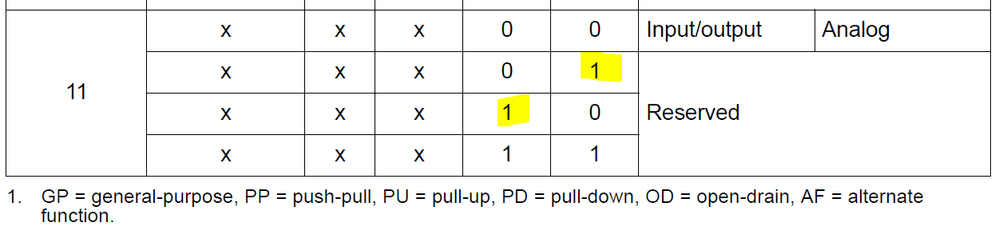

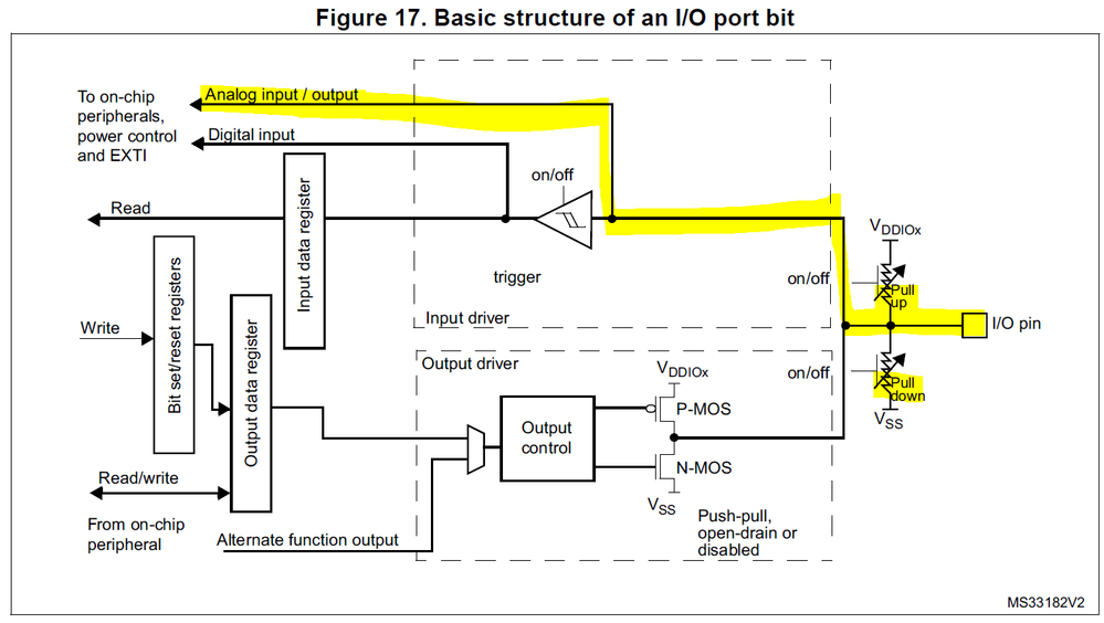

Upon further inspection, the reference manual explicitly doesn't support the pull resistors in analog mode.
From the port structure, it seems like they would be able to be activated. I didn't try it. It may or may not work, but CubeMX seems right here not to allow you the option based on the reference manual.
I did not remember this correctly: it's the other way round - with TTa pins, in 'F0, the ADC is connected even in non-Analog modes.
https://community.st.com/s/question/0D50X00009XkaBB/stm32f0xx-findings
I don't recommend this mode of operation to be used for ADC, though.
