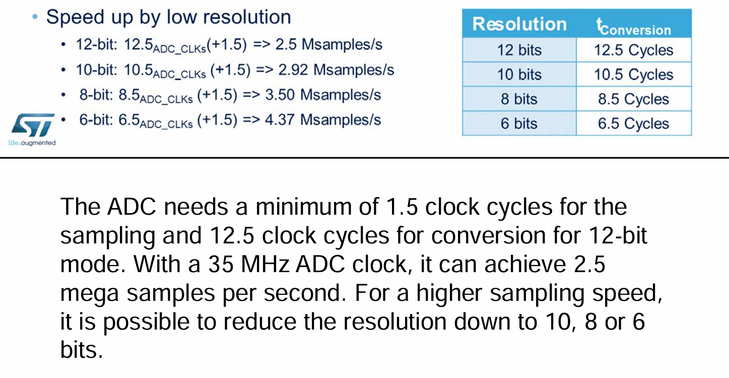

The G030 has a 12-bit ADC with 2Ms/s
ADC clock of 32 MHz divided by 2 = 16 MHz (12.5 + 1.5) should be 1.1Msample/s? is not it?
Is this practical?

You mean that, for example, in this microcontroller, 2.5Msample/s for one channel cannot be achieved
