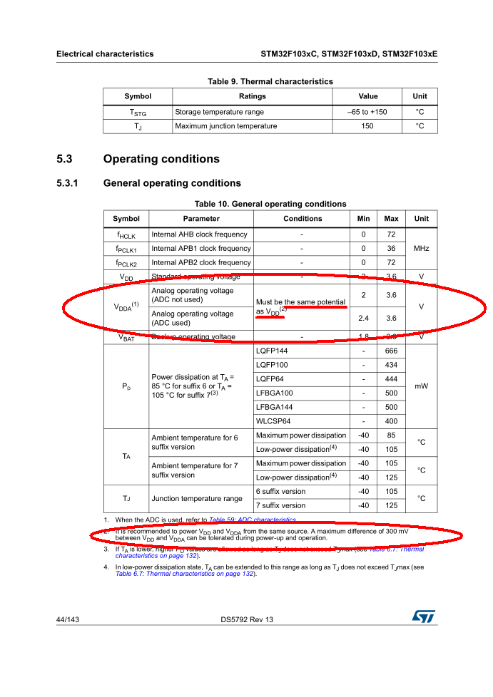

I need STM with external Vref 3V. But I don't need so much pins like 100pins in ST where we have special pin Vref. Could I use VDDA/Vref pin in STM32F103RC according to drawing belloow? I wanna connect precision voltage reference to VDDA on 3V, and normal 3V from other high power source for VDD. Is it possible or not? If is not possible could you explane why? I don't want use external ADC for this application because it is expansive.

Yes it is possible as long as you are aligned with operating conditions described in product datasheet.
My confirmation is also based on the content of AN2566 Getting started with STM32F10xxx hardware development:
To improve conversion accuracy, the ADC has an independent power supply that can be filtered separately, and shielded from noise on the PCB.
But in such case, you need also to pay attention to the details of the section "Power supply schemes": The VDDA pin must be connected to two external decoupling capacitors (100 nF Ceramic + 1 µF Tantalum or Ceramic).
And to complete my answer, I suggest you to have a look to AN2834 for tips on How to get the best ADC accuracy in STM32 microcontrollers.

2021-04-29 5:11 AM
When constructing the power source for VDDA, you have to observe this:
