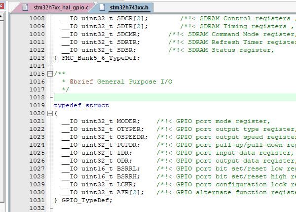

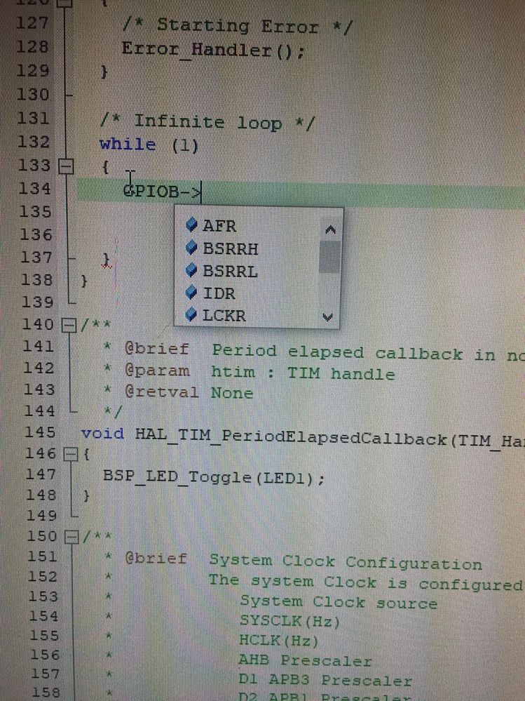

@Community member GPIOB->BSRR =(1<<0); it worked that way, but The use of bsrr register looks like in the picture.There is not error in the program ,but it looks that way.
2019-07-19 5:41 AM
@Imen DAHMEN first image is generated codes in the stm32cubemx 5.2.1 version ,other older version
2019-07-19 5:42 AM
The processor can do 8, 16 and 32-bit writes against memory. The structure can only really describe one width, and most compilers don't support unnamed unions, where you could use different names for memory that falls on the same location.
ST has been inconsistent with library code, seem to recall the F3 SPL used the BSRRL/BSRRH naming.
If you wanted to do a 32-bit write against GPIOB->BSRRL you'd need to cast the address to a 32-bit pointer.

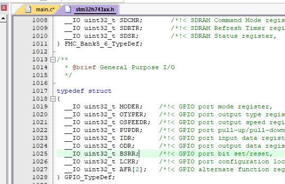

2019-07-19 7:10 AM
Hello @Bilge ,
Which Cube firmware package are you using ?
In fact, in the last firmware package CubeH7 v1.4, we have replaced BSRRL and BSRRH registers (In device header file (ex. stm32h743xx.h) and in GPIO type def) by one 32 bit register BSRR as defined in Reference manual.
Best Regards,
Imen
