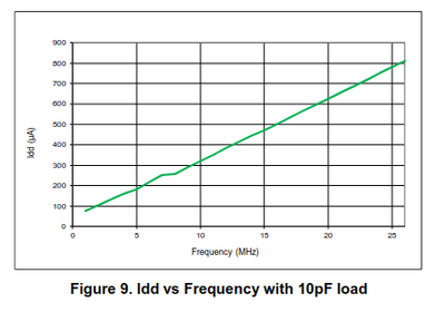

maybe SIT8021AI-J4-XXS-1.162000 (digikey) might get you some uA less, about 100uA at 1,1MHz :
But its case : 1.5 mm x 0.8 mm , 0,41 mm pitch - only for reflow + pick'n place.
