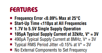

So why not just try with HSE crystal, 4MHz , and check real world value then ?
Or with hse-bypass, maybe the lowest possible consumption (if no crystal precision needed) :
584-C6930IMS88.00TPF (mouser)
So you can expect about 150uA at 1MHz setting for this kind of micro-power-osc.

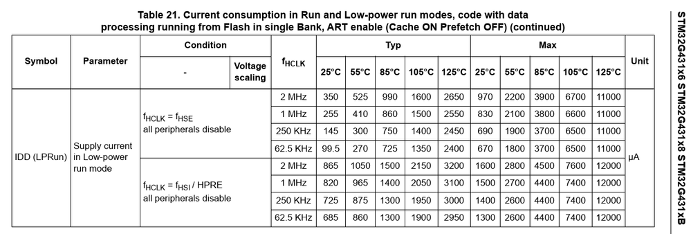

> According to the power estimator, HSI16 does not provide anywhere near the same power reduction as HSE bypass.
HSE with 8MHz crystal consumes around 500uA typ, according to the DS, while HSI16 around 155uA typ 190uA max. You want to divide the AHB accordingly to run the rest of the mcu at the same frequency (say 2MHz), in order to get them into the same consumption level.
HSE bypass does not consume anything, but the external oscillator does, and it will be in the 150uA ballpark.

There's also interesting but generally unusable (expensive, non-crystal-precision) LTC6906.
