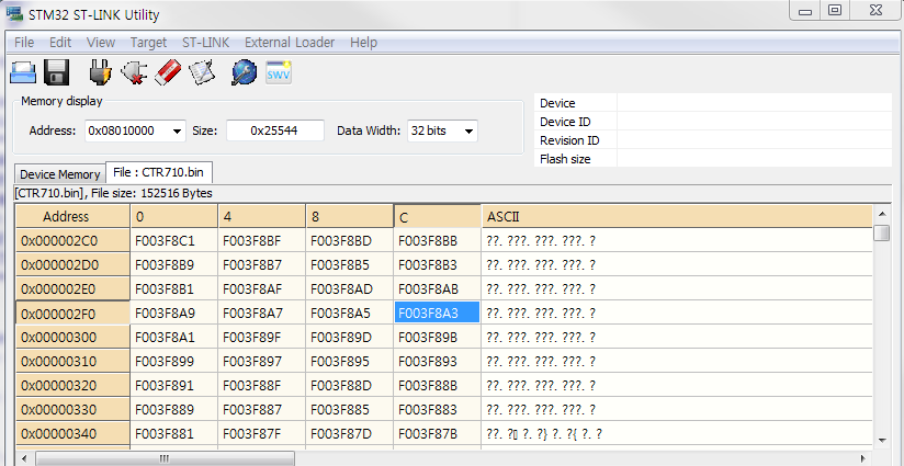

But I can't find 0xfffffff at the 0x2FC, defined in the above AREA.
Please refer to the below binary file.
Could you let me know what is wrong?
Thanks, Bogdan.
2018-01-15 6:45 PM
Code past the END is going to be ignored.
