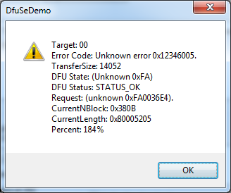

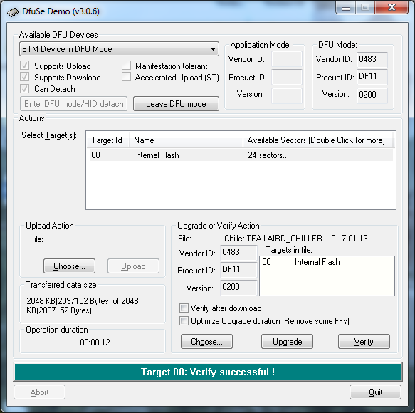

I was able to use elf2dfuse to create a DFU file. DfuSe downloaded the file and verified. However when I reboot my board, the firmware was not updated.I have attached the ELF and DFU files. Also, I included the STM32Cube project et al that I loaded to handle DFU transfer. It enumerates, but not sure if it's actually programming the flash.

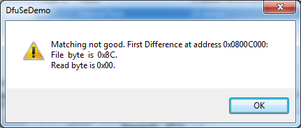

Operator error on DfuSe Demo verify, so ignore the above picture. Now I get:I'm guessing the firmware I have loaded in my board will enumerate as a DFU device, but does not actually program the flash.
2023-01-25 1:12 PM
The .ELF look built differently from the project
Assuming you have a loader of some sort, as the primary .ELF starts at 0x0800C000 address, and not 0x08000000

2023-01-25 1:24 PM
The ELF from the project includes DFU. I use ST-LINK to download it. The other DFU is my project built with WICED. I'll eventually port the STM32Cube source into my project...if I can get it working.
When I try test1.dfu...When I try test2.dfu...
After power cycle, the original STM32 app is still running.
