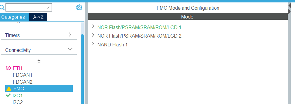

The Cube shows PSRAM capability. If that indeed does work, find a suitable PSRAM...
