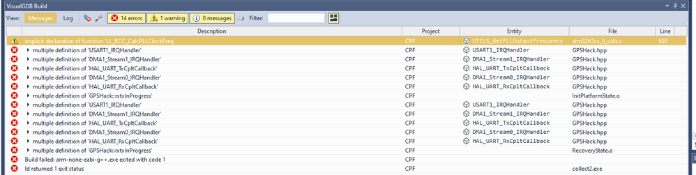

@TDK - Here's the full error
I started this project with the STM32 example for the STM32H7B3 Discovery board but I'm trying to make it work on the STM32H7A3 Nucleo board. My understanding is the B3 is identical to the A3 but has a encryption module so it doesn't seem like that's part of the problem.

*/USART1_IRQHandler is not defined or declared in stm32h7xx_it.c. I actually can't find the declaration by searching for USART1_IRQHandler. This subroutine is the only other place I find a reference to USART1_IRQHandler but I don't really understand what it's doing.

2022-02-13 10:52 AM
> GPSHack.hpp
Ah, so it's a header file. As JW says, you can't have definitions in a header if that file is included from multiple source files. Split it up into a header with declarations and a source file with definitions.

2022-02-13 12:51 PM
That worked! @TDK and @Community member , I'll be happy to buy each of you the drink of your choice the next time you're in the Monterey Bay, California area. Or several drinks. Many, many thanks.
