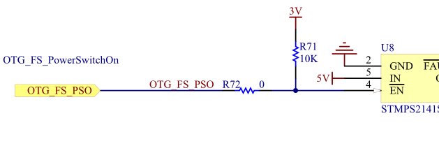

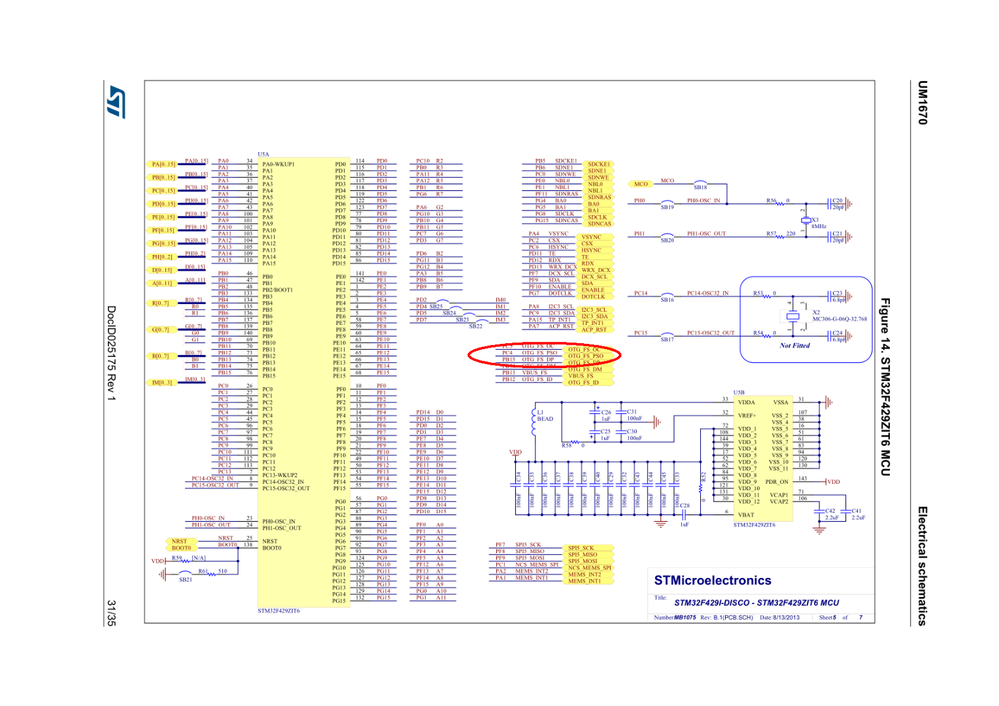

The resistors on the board does not know what are you using in your project, they are always there.

2017-08-16 6:02 AM
