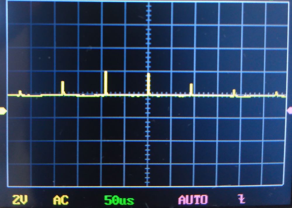

This is the signal from my GPIO pin C13 via a probe (see figure below, I had peaks around every 100us):

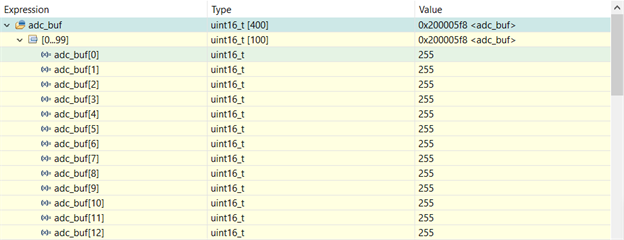

Nevertheless, when I pause my script in CubeIDE, I do see my buffer with ADC values:
Would you say that I’m getting closer to my objective? I’m not exactly sure what is wrong with my code.
