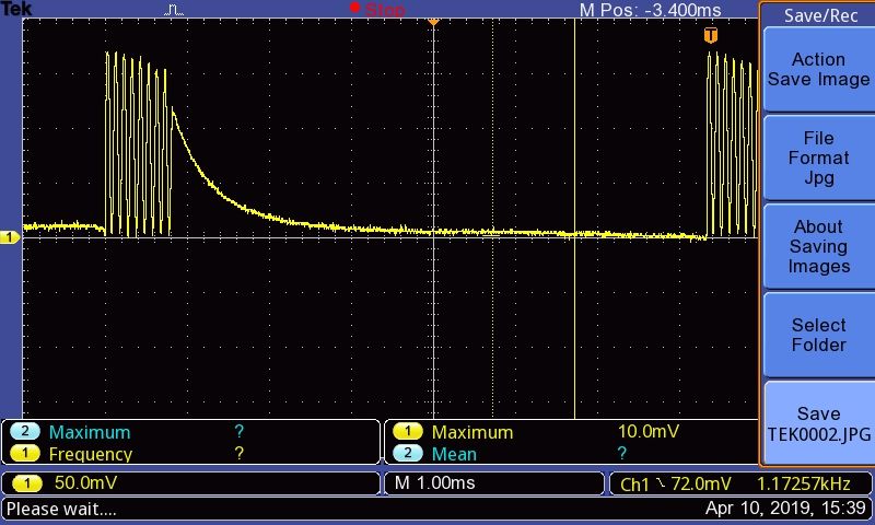

PS : the picture shows a problem i have when i change the SYSCLK frequency from under 4MHz to 8, 16 or 32 MHz. The sinus wave observed is at the right frequency but there are some timelaps where the potential is 0.

But yet, i don't even manage to have a good sinus at 10kHz, i always have the problem mentionned on the picture.

But when i want to change the HCLK to 8MHz, i have the issues mentionned on the topic.
