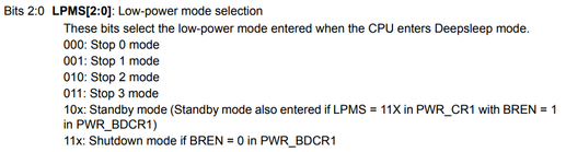

Thank you for the content furnished in your post. In RM0456, page 440, you have all the different values possible for LPMS.
The function HAL_PWREx_EnterSTOP1Mode is using the MODIFY_REG macro, which clears LPMS and set the bit LPMS0. That, way, LPMS value is now 001, or STOP1 mode.
If you want to lower your power consumption, you have to change the LPMS register value as you did, or you can use the following available functions:
Attention 1: Stop 3 mode is actually quite different, please read Tables 99 and 100 in order to check the compliancy with your application.
Attention 2: Standby and Shutdown mode will trigger an internal hardware reset during the wake up.
