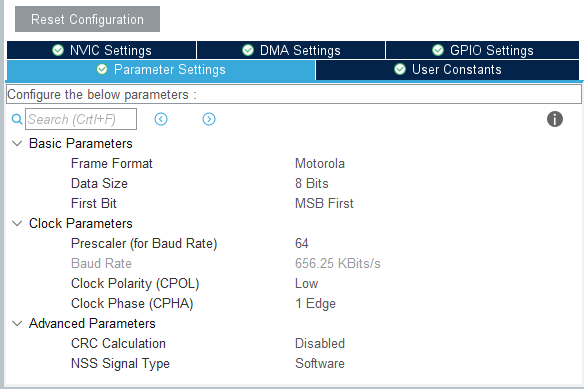

How is the SPI clocked, exactly? If you're tapping the board source are you distorting or stopping it?
The SPI peripheral has a prescaler, but the frequencies you can hit are limited by the APB source. You might have to adjust down the AHB/CPU clock to hit specific targets.

Hi Tesla DeLorean thanks for the reply.ok i will do that . In this inage there is prescalar and baud rate. my doubt is that does this baud rate reperesent the clock given by controller to slave device.
