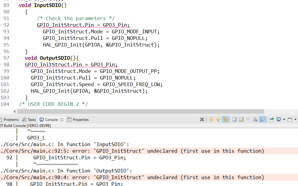

2021-12-09 11:21 PM
Hi. first of all thank you very much. How can I fix this error?
2021-12-09 11:27 PM
Create the variable you are using. You could do so locally within the subroutine.
