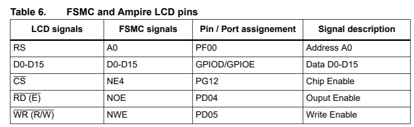

We have D/CX pin along with above pins in LCD. ((D/CX): This pin is used to select “Data or Command�? in the parallel interface).
Can we connect GPIO to D/CX pin, or do we have any dedicated pin in FSMC interface?

Per the link, you need to study the documentation to work that out.
