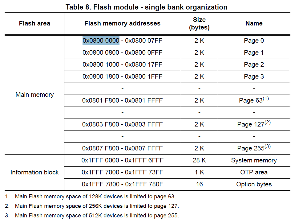

6. Find the address range corresponding to the page number using the table above.

You're erasing page 1, which isn't at 0x08000000. Page 0 is.
