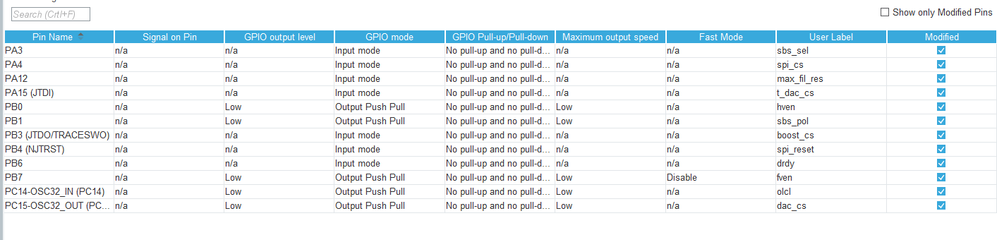

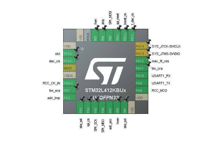

i can switch between all pin but this one is static, pin PC14 (I call it olcl).
I think maybe one of the peripheral units in the card is catching it to me.
this is the code and the setup.
sbs_pol_Pin is swiching states properly.
while (1)
HAL_GPIO_WritePin(sbs_pol_GPIO_Port,sbs_pol_Pin,GPIO_PIN_SET);
HAL_GPIO_WritePin(olcl_GPIO_Port,olcl_Pin,GPIO_PIN_SET);
delay_1u(100);
HAL_GPIO_WritePin(olcl_GPIO_Port,olcl_Pin,GPIO_PIN_RESET);
HAL_GPIO_WritePin(sbs_pol_GPIO_Port,sbs_pol_Pin,GPIO_PIN_RESET);

PC14 would be in the Low Power domain, it has very low current sink/source capability, review Data Sheet, and notes on pin

can you enplane a bit more please?
for exmple when im trying to write a different program which only toggle this pin up and down, it is doesnt changing as well.
i havnt seen nothing on datasheet that neutralize this pin when im working only with this pin.
by the way this is STM32L412KB

2020-05-24 1:41 AM
I'm looking in here https://www.st.com/resource/en/datasheet/stm32l412kb.pdf
and i can not find nothing about it.
there is no specific schematic in there that can help me in the topic you presented.
