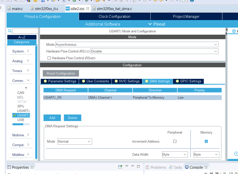

my problem is that the DMA only writes to the first address of the buffer,
means that when i look on the buffer, the last byte of the message is stored in the first place of the array, and the rest of the data is overwritten.
what could be the problem, what am i missing?

Hi. Have you configure DMA with destination address increment by byte?
2020-01-13 2:40 AM
yup
