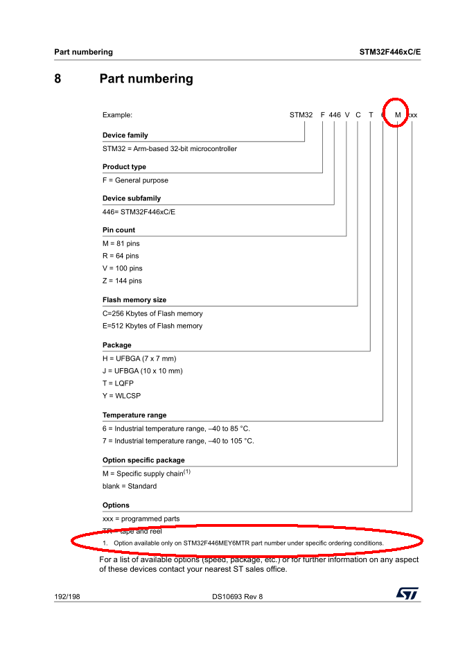

M suffix, the description could not be more weird, "specific supply chain"...

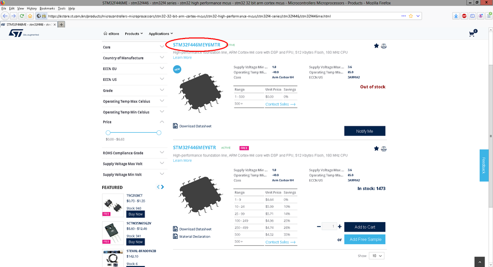

Even more weirdly, it *is* present as a separate part directly in the respective webfolder's "sample&buy":
Btw., what's the point of providing a "boilerplate" picture which has no material connection with the real product? (MEY is WLCSP81)? Isn't ST's web ridiculous enough with its overtly active javascriptoids?
ST, you know what would be really attractive to us? If you'd provide *real photos* of *each and every* product, as they are in real life. No kidding.
2020-09-04 2:00 AM
The ST page you show does not imply availability in my eyes.
2020-09-04 2:11 AM
Well, then you have to source it from some non-specific supply chain, I guess... ;)

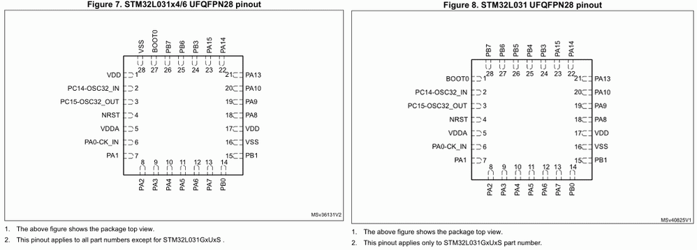

S suffix in 'L031 in QFN28 means "different pinout from the non-S suffix", but it also means "the same pinout as 'L011 and 'F031 in QFN28". Nice.
