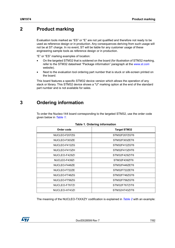

From the 'G4 DISCO UM2577:
This board features a specific STM32 device version, which allows the operation of any bundled commercial
stack/library available. This STM32 device shows a "U" marking option at the end of the standard part number
and is not available for sales.
In order to use the same commercial stack in his application, a developer may need to purchase a part number
specific to this stack/library. The price of those part numbers includes the stack/library royalties.
I can find no mention of the U suffix on the 'G474 product folder webpage, nor in the DS.
ST, can you please properly document it this time?

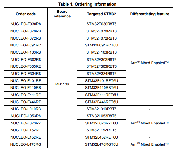

Hi @Community member ,
I don't think that the "U" suffix is specific only for the STM32G4 Discovery board.
Look at UM1724: STM32 Nucleo-64 boards (MB1136), we have following table with several devices having U suffix:
In the datasheet, suffixes other than "TR" are described as "programmed parts".
-Amel

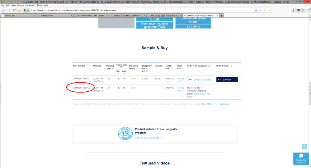

More weird and undocumented suffix: E
PS. Parallel thread https://community.st.com/s/question/0D50X0000BXn5PJSQZ/what-is-the-difference-between-stm32h743zit6-and-stm32h743zit6u
