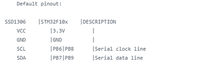

@adityapruthi01 wrote:
Perhaps can you guide me with which pins should i connect my oled to my board?
Thanks.
The pins connections are described in the header of the ssd1306.c file:
Don't forget to add pull-up resistors on SCL and SDA lines for I2C bus.
Otherwise as said by @Andrew Neil you need to start with very simple projects to be familiar with ST environment and its MCUs.
2024-11-06 5:26 AM
You can also confirm the pin connection for I2C in https://github.com/guiguitz/RTC-OLED-Application/blob/main/NUCLEO-F401RE-RTC-OLED-Application/Src/stm32f4xx_hal_msp.c :

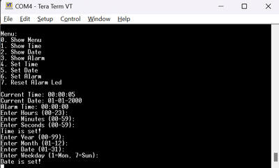

2024-11-07 2:13 AM - edited 2024-11-07 5:46 AM
void HAL_TIM_PeriodElapsedCallback(TIM_HandleTypeDef *htim)
if (htim->Instance == TIM3)
// Your 1-second interrupt handling code here
Print_Date_Oled();
Print_Time_Oled();

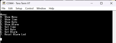

which is used to display the time and date on the OLED, the Terra Term does not work and there is no feedback when pressing any keys while trying to change the date and time.
The above is showing like this when trying to press any key on the num pad.
But actually it has to be like this.
The above happens when I commenting out the Print date and time function.
So either I am able to use the RTC functionality or miss displaying it on the OLED, or I am able to Display on the OLED missing RTC functionality.
The video for the same can be found here https://www.youtube.com/watch?v=Nm-16YhCYl8&t=1438s
Github for the same original project is located here: https://github.com/PRTechTalk/STM32/tree/main/G071_LCD_RTC.
Can you please check.
Thanks and Regards
