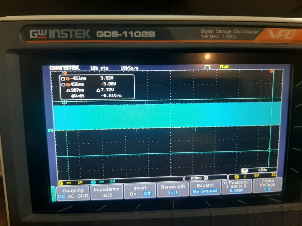

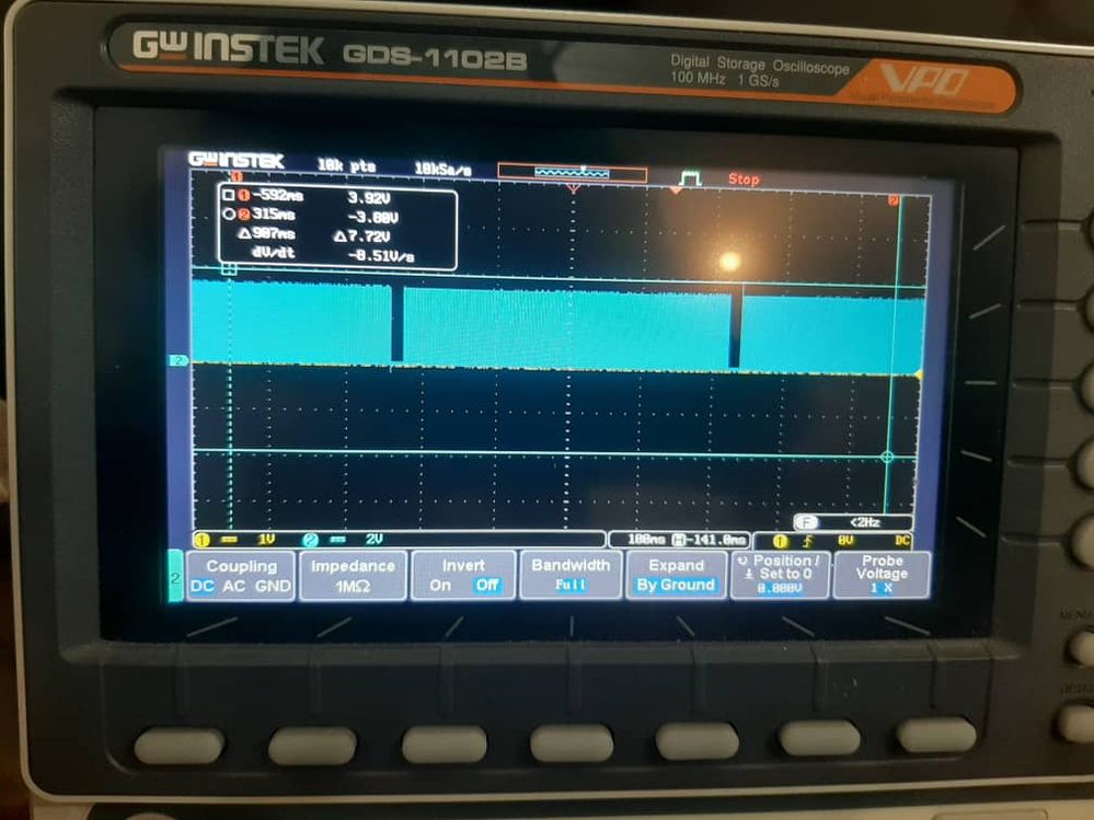

2020-12-05 8:25 AM
The first image is PWM output when using internal oscillator & The second image is PWM output when using external crystal.

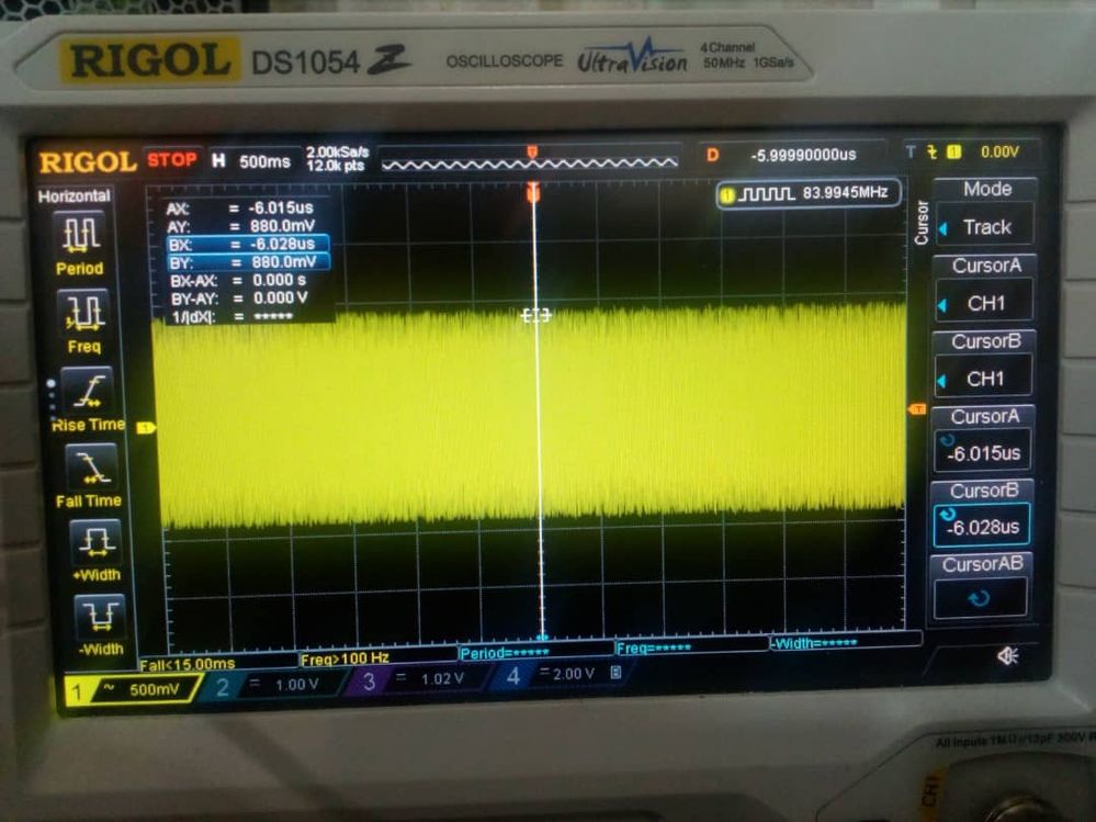

2020-12-06 3:46 AM
Thank you for your help. The MCO output is OK.
This image is MCU output.
I also found that the frequency of the disturbance varies with PWM frequency.
For example the frequency of the disturbance is 2 Hz when PWM output frequency is 15000 Hz &
the frequency of the disturbance is 0.5 Hz when PWM output frequency is 3750Hz.

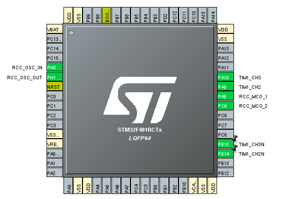

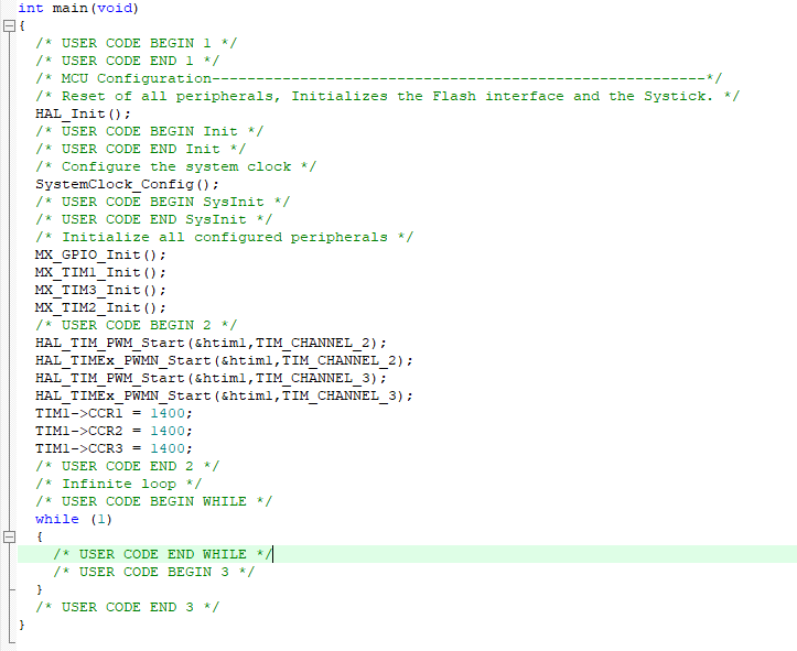

The timer peripheral isn't likely to contain a glaring hardware error which would cause this. The STM32F4 family is very mature. I would look at your code to see what might be causing this to happen. Perhaps in an ISR routine affected by the frequency of this particular timer somewhere.

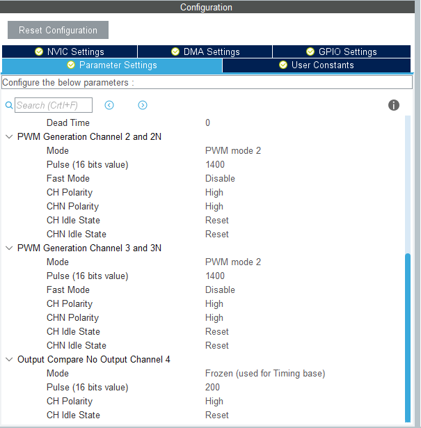

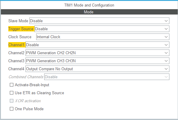

2020-12-06 9:42 PM
Yes, Of course.
Here you are.
The code is very simple and we don't have any ISR routines. We just have a PWM signal with frequency = 15KHz & Duty cycle = 50%.

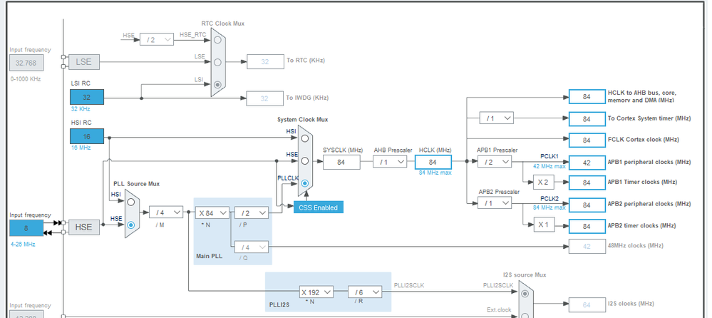

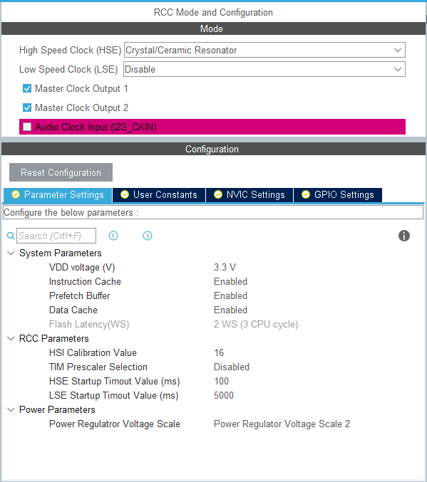

2020-12-06 11:22 PM
Try to switch off CSS.
2020-12-07 2:38 AM
Thank you for your attention. I tried that. Nothing was changed.

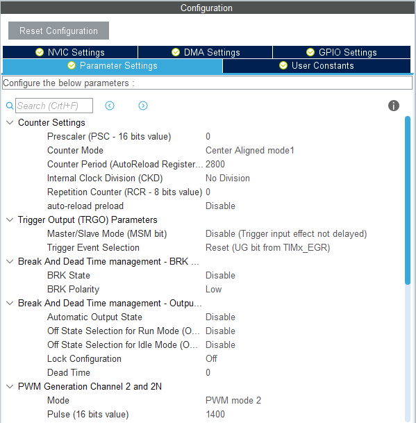

2020-12-09 12:10 AM
Thanks. I did it. The disturbance was not removed.
I found that when we remove deadtime, The disturbance is removed.
But I need deadtime.
2020-12-22 7:21 AM
Hello. I found that when the PWM period is an integer multiple of the dead time, The disturbance is removed.
Do you know why this happens?
Do you know anything about this fact?
