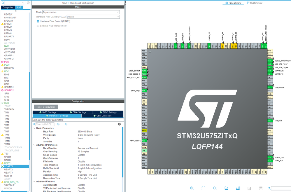

I am using stm32u575zit6q.
I set Baud Rate 2500000bit/s.(my equipment is only support 2500000bits)
usart write is work successful, but read is not.
usart read work only 9600bit/s.
How do I use the read to work over 9600baud rate?

I am using usart as polling in my project.
If you only apply from DMA, I am willing to use that.
HAL_UART_Init() does not any error. The basis for judgment works normally to go to the while statement in which the user code is put in the main statement. (When using write only)

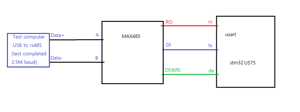

my system is using MAX485CSA
MAX485CSA moudle is using this site.(https://www.navimro.com/g/440674)

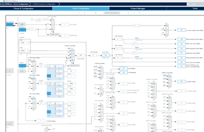

here is clock source setting.
Set to 150MHz to set the 2.5M Baud.
