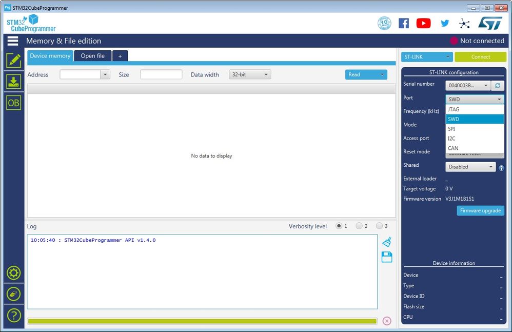

2019-01-26 12:56 PM
The Cube programmer offers CAN as a Mode for the ST-LINK connectivity.

Then, I don't understand. If I use the CAN mode with a ST-LINK V3, I could flash my board through bootloader CAN using the "start programming" button, couldn't I ?
