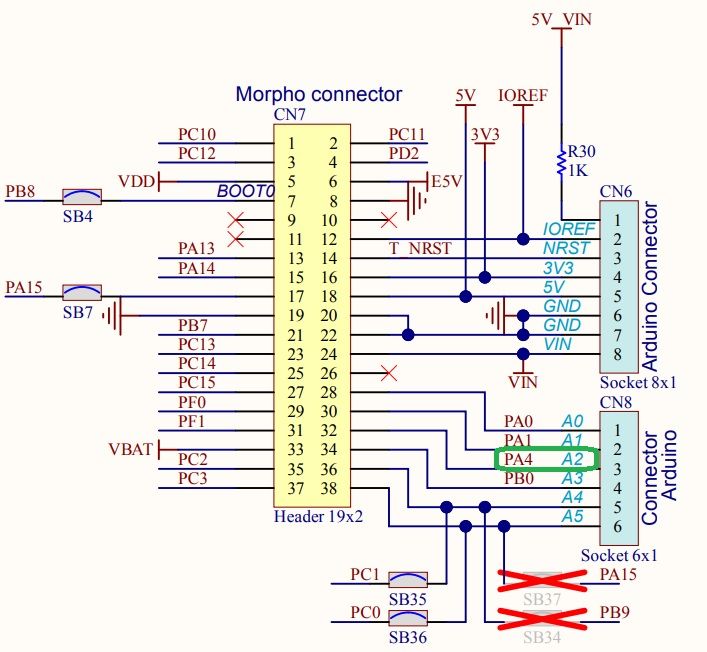

Set given pins to GPIO Output and toggle them - do you see that on oscilloscope?

I did not ask whether the oscilloscope is working, but whether the pins, which you are using for DAC, when set as GPIO outputs and toggled, do produce the expected waveform.
If this is successful, then set up GPIO as needed for DAC, set up the DAC control register for operation without trigger (and without DMA and timer and whatnot) and try writing into the DMA holding register. If that fails, read out and check/post the DAC and GPIO registers content.

Pity you still don't answer Jan's question.
PA4 is connected to Arduino Rail A2 pin
If you drive pin high/low as a GPIO does that work?
According to the schematic it's directly connected to the IC, so no solder bridges or anything in the way.
2022-06-23 12:42 PM
Excuse me! There are no jumpers. Connected to pin A4(A2 - CN8). SB37 and SB34 were not installed at the factory
