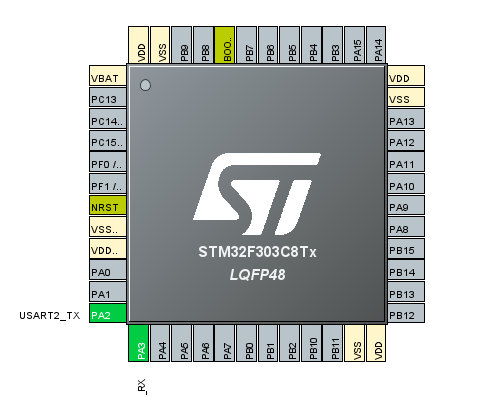

i've send data with uart protocol and wanted to visualize this data with this Realterm software but the com port didn't appear and i've used the ST-Link USB.
and i'm out of solutions right now and i can use some help.
2021-04-13 8:01 AM
Show what you've actually coded, the USART used, and the pins.
2021-04-13 8:11 AM
nothing it's just a simple code that i want from it to visualise what i just send with the realterm software but the com won't appear
