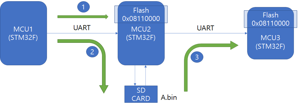

1. Receive binary file from MCu1 to UART and save it to SD card (or EEPROM).
2. Write the binary file stored in the SD card (or EEPROM) to the specific flash memory area of MCU2.
3. Write the binary file stored in SD card (or EEPROM) to the specific flash memory area of MCU3 using UART.
I hope you can understand my question well by referring to the picture.
If you have code or special documents for the above three functions, please let me know.
Have a nice day.

Assume few here are interested in doing your work assignments.
Application Note AN3155 covers the UART protocol in the ROM
Example driving BOOT/RESET pins and pushing firmware to a secondary device
https://github.com/arduino-libraries/MKRWAN/tree/master/examples/MKRWANFWUpdate_standalone
