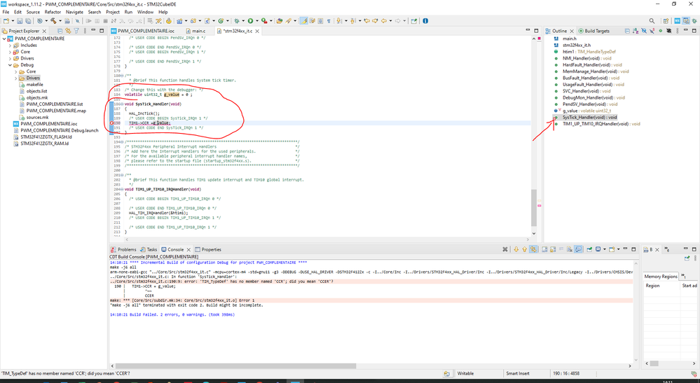

2023-04-11 11:13 AM - edited 2023-11-20 8:31 AM
@pavel A. look
2023-04-11 11:18 AM
It complains about nonexistent TIM1->CCR - missing 2 in TIM1->CCR2.
2023-04-11 11:29 AM
thank you there are more errors but I don't see where I have to vary the duty cycle
