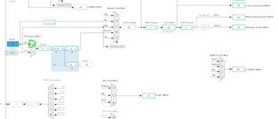

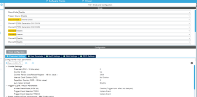

The hardware is STM32G030K8.
When the motor stops, it flicks. My first guess was a lack of capacitance of DC bus capacitor. But it was perfect. I see jitter.
This alone makes you think there is PWM jitter?
There is jitter due to using HSI, but far below anything that matters for motor control.
