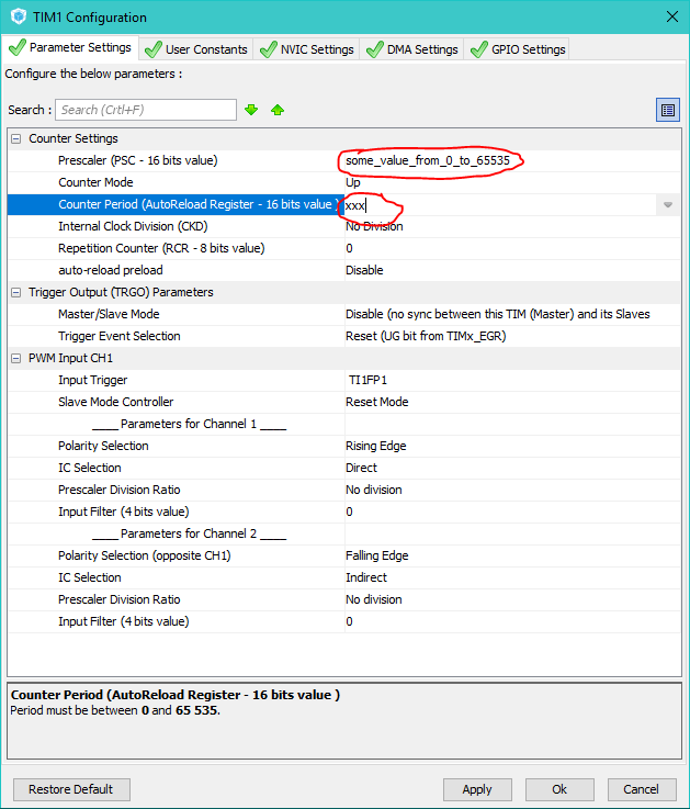

PWM Input mode is selected from the combined channels droplist.
To start the PWM Input , in your main function, call HAL_TIM_PWM_Start (for both channels).
Inside TIM1 settings, the counter period(AR Register) must be higher than PWM period you try to measure.
regards

Hello!
The settings are for the timer as my first's answer figure.
Additionaly, about timer's settings like below
Prescaler value divides TIM1 clock by PSC+1 and feeds the Counter.
To have the maximum resolution from PWM Input, AutoReloadRegster Value can be set to 65535 (maximum) and prescaler can be adjusted, so the maximum counting period of TIM1 to be longer than measurable PWM period.
Example
Want to measure the PWM output from a RC receiver.
Desirable resolution 1 microsecond.
Max period is 20ms
we are not interesting about duty cycle that is between 1 and 2 ms because is allways shorter than period.
TIM1 clock is 120MHZ
Solution: PSC is 119 (120000000Hz /1000000Hz -1) to have 1MHz or 1 microsecond counting period. And ARR can be above 20000 (20ms), put 65535.
With theese settings can measure using 1us resolution, any PWM pulse with period up to 65,5 ms (~15Hz)
