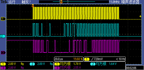

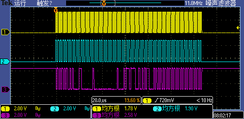

Post relevant oscilloscope/logic analyzer screenshots.

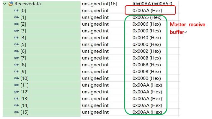

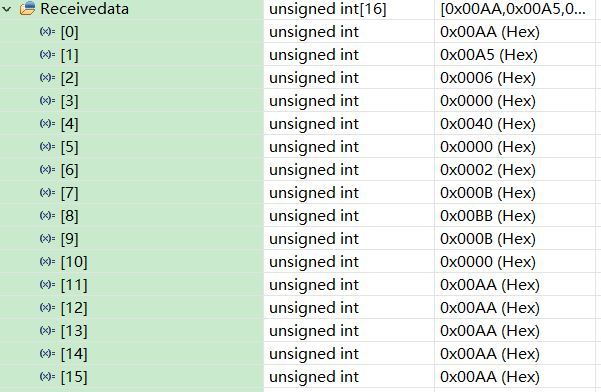

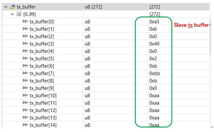

No NSS activity from master, just three lines, slave send(hex) A5 06 00 40 00 02 0B BB 0B 00 AA AA AA AA AA AA
but master receive (hex) AA A5 06 00 40 00 02 0B BB 0B 00 AA AA AA AA AA everytime, looks like last AA is always in the spi tx register

actually, i'm sure slave is ready, because when i see the slave spi tx buffer is already loaded with new data then i start next master transmit manually, but the first byte is still 0xAA when master received, i think 0xAA is the last byte that last frame send , it stays in spi tx register, am i right?

The DMA stores a byte into the SPI Tx holding register whenever it sees it is empty.
So yes, 0xAA is from the end of the previous transaction.
I meant, if you control the very first transaction after reset, you shouldn't run into this kind of mis-synchronization. If the slave has always exactly16 bytes to transfer, and the master will always receive 16 bytes, ever since from the reset, you can't see the pattern you see.
