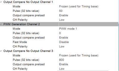

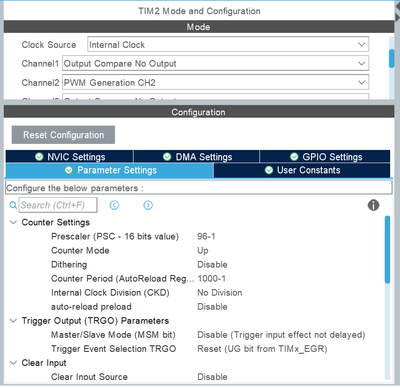

2023-12-20 4:08 AM
Hi @gbm ,
I have done some changes in my code.
For every pwm pulse start at 50 usec I am setting the user_led and reseting the led1 and at 800 usec I am resetting the user_led and seting the led1.
But with below code For every pwm pulse at 12 usec setting the user_led and reseting the led1 and at 24 usec (means after 10 usec of setting the user_led and reseting the led1) resetting the user_led and seting the led1 is happening.
HAL_TIM_PWM_Start_IT(&htim2, TIM_CHANNEL_2);
setPWM_DutyCycle(TIM_CHANNEL_2,50);
void HAL_TIM_PWM_PulseFinishedCallback(TIM_HandleTypeDef *htim) {
if (htim->Instance == TIM2) {
if (htim->Channel == HAL_TIM_ACTIVE_CHANNEL_2){
HAL_TIM_OC_Start_IT(&htim2, TIM_CHANNEL_1); //for 50 usec
HAL_TIM_OC_Start_IT(&htim2, TIM_CHANNEL_3);//for 800 usec
void HAL_TIM_OC_DelayElapsedCallback(TIM_HandleTypeDef *htim) {
if (htim->Channel == HAL_TIM_ACTIVE_CHANNEL_1){
HAL_GPIO_WritePin(GPIOA, user_led,GPIO_PIN_SET);
HAL_GPIO_WritePin(GPIOB, led1_Pin,GPIO_PIN_RESET);
HAL_TIM_OC_Stop_IT(&htim2, TIM_CHANNEL_1);
else if(htim->Channel == HAL_TIM_ACTIVE_CHANNEL_3){
HAL_GPIO_WritePin(GPIOB, led1_Pin,GPIO_PIN_SET);
HAL_GPIO_WritePin(GPIOA, user_led,GPIO_PIN_RESET);
HAL_TIM_OC_Stop_IT(&htim2, TIM_CHANNEL_3);
}For PWM I configured TImer2 with 1Khz.duty cycle I am setting through function.
For 50 usec channel1 I set pulse to 50 is it correct or not?same with channel3 for 800 usec.
Please suggest.
Thanks
