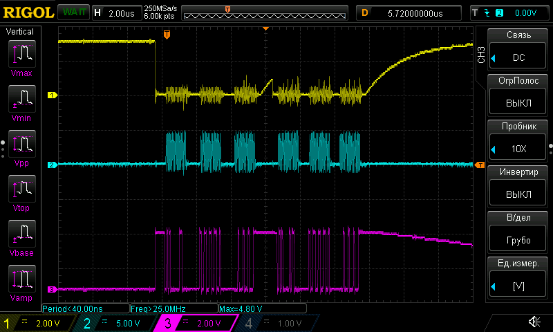

I use SPI1 on stm32F7 as a master only mode with SSOE config bit. My system use SPI clock speed 13,5 MHz. GPIOA#4 is used as NSS pin alternative function 5, push-pull output.
This configuration does not work, but if I set pull-up mode on NSS pin I see (NSS is yellow):

NSS is weird, it's an open collector output that needs a pull up resistor to work properly.
Throw a ~5k pull up on it and it'll go

In the figure you can see that the processor speed is not enough to send data to SPI continuously, I'm thinking of rewriting the interrupt handler in assembler. What HAL can we talk about?
