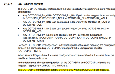

Hello @unsigned_char_array ,
Please make sure that both OSPI instance are disabled to configure OCTOSPI Manager. This behavior is mentioned in RM0468 Rev 3 section 26.4.2.
So I advise you to avoid the OSPIM configuration issue to call HAL_OSPIM_Config only one time at boot. After this, HAL_OSPI_Init() and HAL_OSPI_DeInit() can be called at any time.
Before called a HAL_OSPI_DeInit() it is necessary have to be sure that no Rd/Wr access are ongoing, especially in Memory Mapped Mode where there is no feedback on this access inside OSPI block.

2024-03-26 3:10 AM - edited 2024-03-26 3:55 AM
"Please make sure that both OSPI instance are disabled to configure OCTOSPI Manager."
HAL_OSPIM_Config does this automatically, but maybe it does it improperly. I will check if I can make some type of fix.
