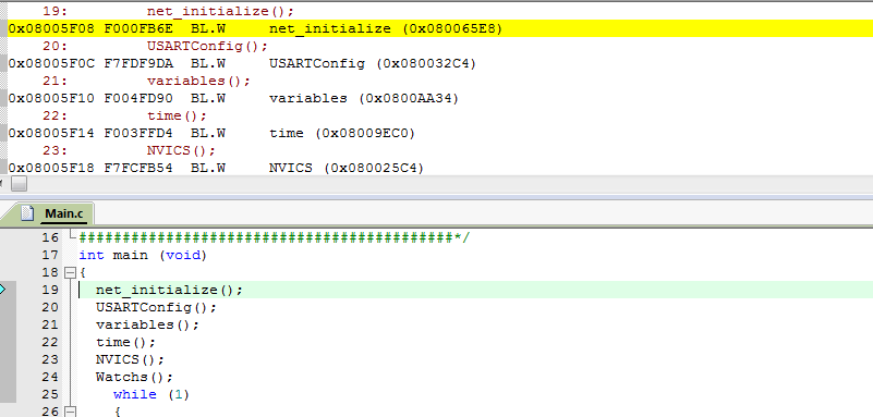

my code works fine and send and receive data and unfortunately it hangs after for several seconds.As I debug my MCU I see that net_initialize() make it hangs(but I call it only once).
2016-10-11 11:18 AM

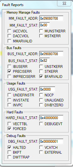

This is not where the fault is actually occurring, you need to dig deeper and look at the registers and the assembler code immediately around the code that faults. before/after. Don't rely on the tool-chain to point to decode the stacked fault context, or understand the generated code.
Do you have an adequate stack for your local/auto allocations, call tree, and interruptions? Implement a proper Hard Fault Handler, and review the dozens of threads covering this class of failures. Observe also that sprintf() returns the length of the string it is creating.2016-10-11 12:07 PM
