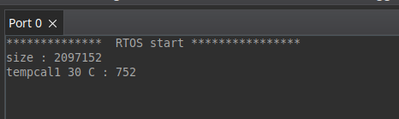

its a problem with the cache : disable cache, then see:
	  int flsz = FLASH_SIZE;
	  printf("size : %d \n", flsz);
	  int regval = *TEMPSENSOR_CAL1_ADDR;
	  printf("tempcal1 %ld C : %d \n", TEMPSENSOR_CAL1_TEMP, regval);
To be able to read into system flash you need to disable the cache associated to this area.

AScha.3
Super User
This can be done by setting non cacheable attribute this this region.

Thank you so much!
ingwmeier
Senior
  /* Disable MPU before perloading and config update */
  LL_MPU_Disable();
  /* Define Not cacheable memory via MPU */
  LL_MPU_ConfigAttributes(LL_MPU_ATTRIBUTES_NUMBER1, LL_MPU_NOT_CACHEABLE);
  /* BaseAddress-LimitAddress configuration for RO area*/
  LL_MPU_EnableRegion(LL_MPU_REGION_NUMBER1);
  LL_MPU_ConfigRegion(LL_MPU_REGION_NUMBER1,LL_MPU_REGION_ALL_RO,LL_MPU_ATTRIBUTES_NUMBER1, 0x08FFF800UL, 0x08FFFFFFUL);
  /* Enable MPU */
  LL_MPU_Enable(LL_MPU_CTRL_HFNMI_PRIVDEF);
Why not add these lines of code through CubeMX if cache is enabled?
