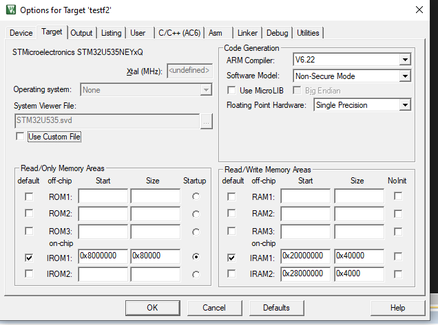

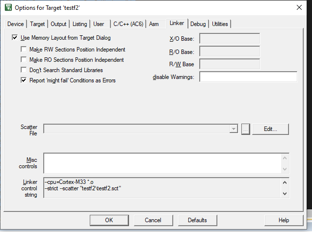

2024-07-23 10:08 AM
Erasing the code that is currently running is expected to cause a hard fault. Are you sure you're not using page 4? Show your linker file.

2024-07-24 7:04 AM
It looks like page 4 might be in use by your user program code. It can not be erased then.
Change the size of IROM1 section not to include the sectors you want to write to.
2024-07-29 12:09 AM
Thanks for your answer, I've tried it and it doesn't enter HardFault anymore.
