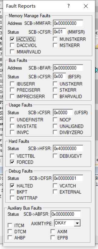

1. The fault reporter(debug):

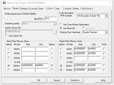

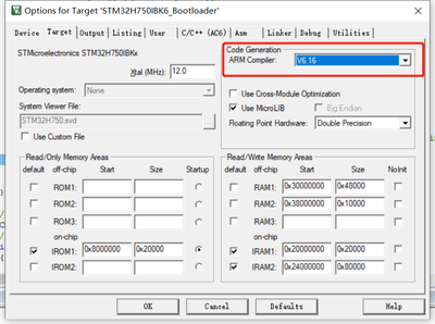

LOL, The reason is my customer bootloader is use "V6.16 ARM compiler", and the application uses "V5.06 ARM compiler".
Boot compiler:
App compiler:

Looks like jump to 0 (corrupted pointers or variables on stack?). Try to debug, single step from your bootloader to few first instructions of the app reset handler.
Boot compiler:
App compiler:
2023-07-19 4:09 PM
Compiler version is not the cause the issue. Your broken code is!
