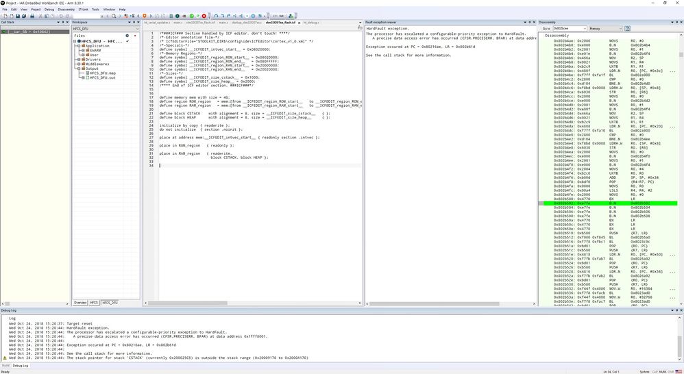

//Fault exception viewer
HardFault exception.
The processor has escalated a configurable-priority exception to HardFault.
A precise data access error has occurred (CFSR.PRECISERR, BFAR) at data address 0x1fff8001.
Exception occured at PC = 0x80216ae, LR = 0x802b61d
See the call stack for more information.
//Debug Log
The stack pointer for stack 'CSTACK' (currently 0x200025C8) is outside the stack range (0x20009170 to 0x2000A170)
What is the problem?

I set icf file
define symbol __ICFEDIT_intvec_start__ = 0x08020000;
/*-Memory Regions-*/
define symbol __ICFEDIT_region_ROM_start__ = 0x08020000;
define symbol __ICFEDIT_region_ROM_end__ = 0x080FFFFF;
I set stm32f2xx.c file
#define VECT_TAB_OFFSET 0x20000
void SystemInit(void)
RCC->CR |= (uint32_t)0x00000001;
RCC->CFGR = 0x00000000;
RCC->CR &= (uint32_t)0xFEF6FFFF;
RCC->PLLCFGR = 0x24003010;
RCC->CR &= (uint32_t)0xFFFBFFFF;
RCC->CIR = 0x00000000;
SCB->VTOR = FLASH_BASE | VECT_TAB_OFFSET; /* Vector Table Relocation in Internal FLASH */
#define FLASH_BASE 0x08000000U /*!< FLASH(up to 1 MB) base address in the alias region */
