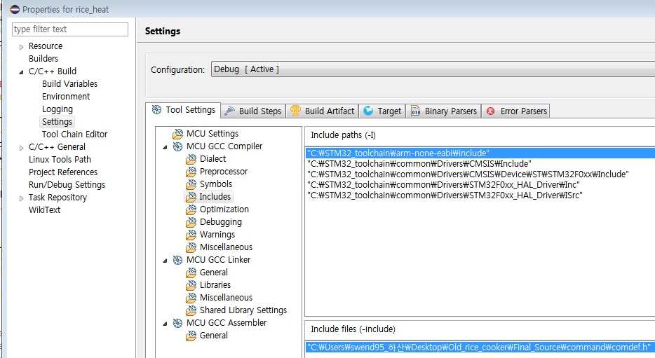

It still sounds like you don't have the Include Paths set correctly, and I really can't tell what you actually have set up as you don't provide any screen shots to be able to validate your assertions that it is as it should be. This list of paths may well contain a half-dozen directories that the compiler searches in order for ''foo.h'', etc. If it can't find the file it is because it is being told to look in the wrong places.
General rules for Keil are that your paths should not be off the Desktop or other virtual directories, should not contain odd characters and/or hieroglyphs, and should avoid spaces or things that could be misinterpreted.2016-11-16 5:49 PM

Viewing the image you posted, the path separation characters don't look good.
When I look at my configurations, it's either '\' or '/'.2016-11-17 12:05 AM
Dear Sir AvaTar,
Do you mean its should be with a bar like / ?Or do you mean in this way... 'C:\STM32_toolchain\common\Drivers\CMSIS\Device\ST\STM32F0xx\Include'?Have you see other setting which I have been attach in this before this conversation?RegardsHasan2016-11-17 1:34 AM
That is how it looks like on a Windows platform.> Do you mean its should be with a bar like / ?
Other platforms (Unix and Unix-like's) use the (forward) slash. Eclipse is platform-independant and can deal with both, especially with '/' on Windows platform. I have the suspicion your ''missing'' file is the very first include file the toolchain is going to search. Can you post the full build log (including the call command line) ? In Eclipse, it is the output that ends up in the ''Console'' window.
