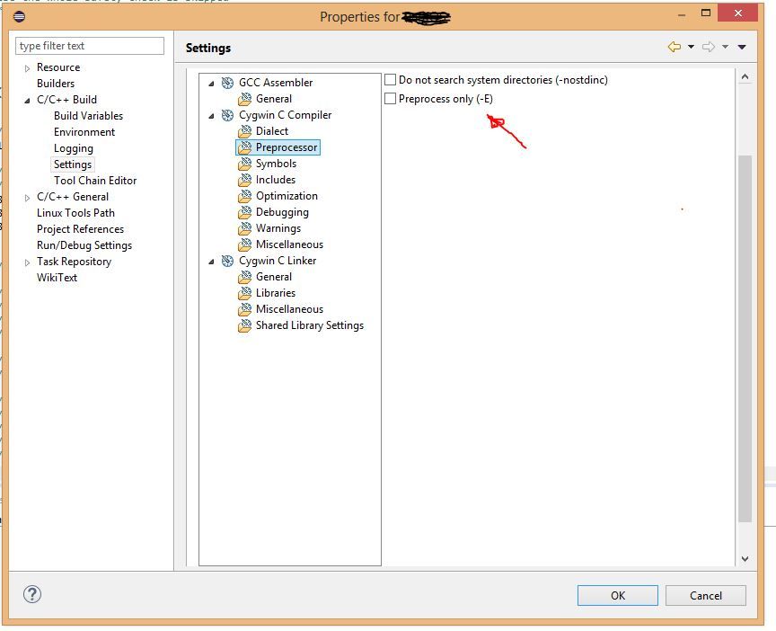

You might have come across an issue with most Eclipse IDEs - the parser it uses in the editor view is NOT the toolchain/compiler it uses for the build. Obviously, the target compiler is the decisive criteria here.> ..\inc\Src\stm32f0xx_hal_flash_ex.c:990:1: error: expected '{' at end of input
I would try adding the ''-E'', and view the preprocessed output the compiler would see.

Coocox is also Eclipse-based, at least it was the last time I had a look (and discarded it).> 1.Do you talking about setting in Preferences> c/c++>makefile error persor?
I never tried to mess with the parser settings, and simply ignored those parser remarks. Just to clarify, I experienced the same issue with Eclipse-based toolchains for the x86 family ...> 2. Where you wanted to adding -E?
> 3.Preprocessed output setting is where?
On a plain Eclipse it looks like this (right-click on the project, select ''Options...''):
