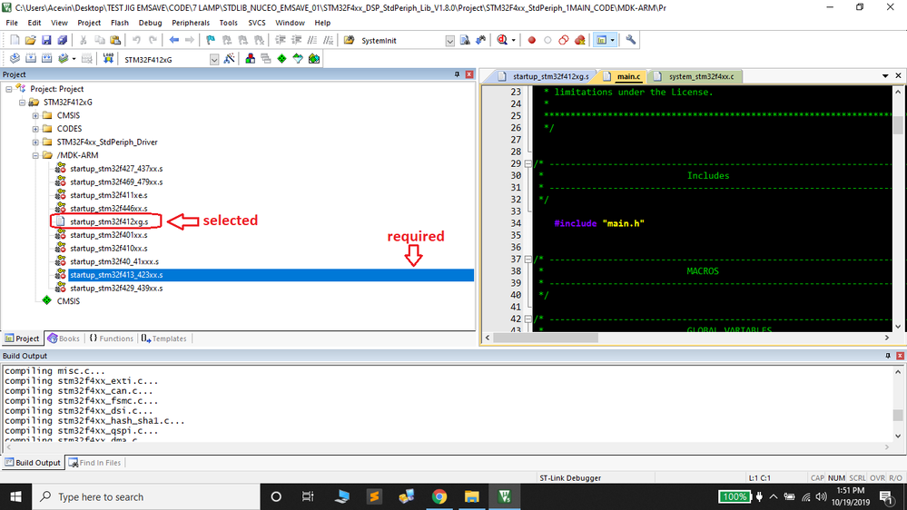

2019-10-19 1:27 AM
Thanks @Community member ,
The default startup-file in the template code of SPL4XX's is selected to startup_stm32f412xg. Hence, it was generating a "Hard Fault".
About crystal, I've connected an external crystal of 8Mhz, but there is no perfect combination of PLL-M, PLL-N, PLLP, PLL-Q and PLL-R which will gives me exact 50Mhz. Same goes for 100Mhz too. Checked on CubeMX software.
In addition to that, do you know could I change or re-select the startup-file in Keil?
2019-10-19 1:27 AM
> How do you know it's on receive interrupt?
I've got the answer: The default startup-file in the template code of SPL4XX's is selected to startup_stm32f412xg. Hence, it was generating a "Hard Fault".
