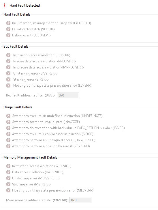

And this is the fault analizer viewer from stm32cube ide:

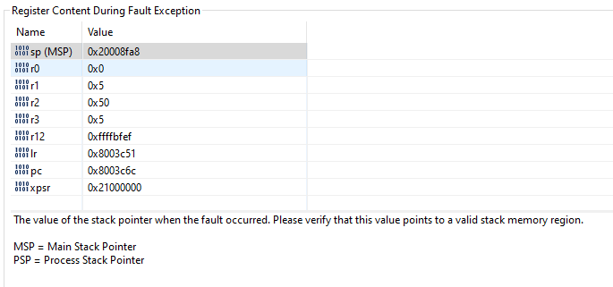

The Register content is this one:
I can't realize where is the trouble, even fault analizer didn't show a partircular issue. This code operation is a simple cast from 4 bytes uint8_t buffer[] to uint32_t.
2021-11-24 3:41 PM
The Cortex-M0+ processor, which is core in 'G0, does not support unaligned accesses, i.e. you must not read an uint32_t from an address which is not multiple of 4.
Read 4 bytes and assemble them into the uint32_t "manually".
