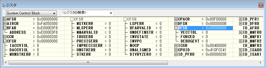

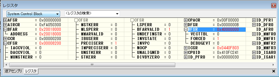

However, when I type 64th character 'b' Hard Fault raised as following.
'b' exists at receive_str[63] by DMA.
PRECISEERR is 1 , BFAR = 0x20018000.
It looks unwanted memory access to 0x200018000, did not such access.
DMAC is still transfers Rx data correctly.

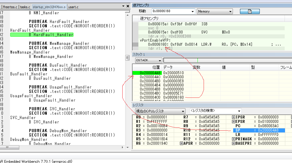

I typed 'c' 3times, then the buffer is overwriten circulariy as expected.
At the time, I lookd stack.
Does anyone know my mistake, or how to workaround?
