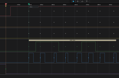

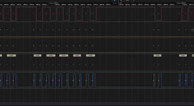

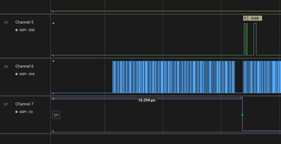

2025-04-30 2:24 PM
I think the issue was the “memory size” settings. I had this set to 16 Bits, but when I bumped this to 16Gbits it fixed the transmit error. This seems odd since I am not using memory-mapped mode.
Some additional questions.
Background: I am sending 640 bytes of data with @ 100 MHz
Instruction: 1 Byte: 0x32
Address: 3 bytes
Pin settings: Very High Speed
I am using DMA and enabled burst length of 64
