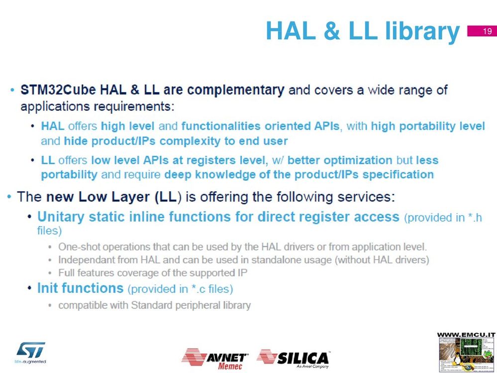

2021-11-22 12:02 AM
the difference between LL and HAL
